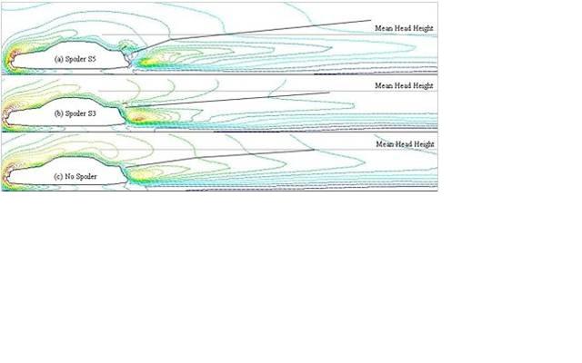

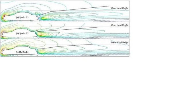

Pas op met uw spoilers. Uit onderzoek blijkt dat het de uitlaatgassen soms precies op hoofdhoogte van voetgangers, fietsers etc doet uitkomen. de mate van vervuiling blijft hetzelfde maar richt precies op de neus van de voorbijganger.
Like the tail fins of yore, rear spoilers on the majority of today’s passenger cars are primarily appearance enhancers, not downforce tools, because the benefits of downforce are only apparent at high speeds. A new study suggests that rear spoilers do serve a dynamic purpose — one that might induce coughing fits in transportation-design classrooms.
Aonghus McNabola, a lecturer in the engineering department at Trinity College in Dublin, concluded in a recently published paper that rear spoilers set at certain angles created plumes of tailpipe pollution at the head height of pedestrians, cyclists and motorists who might follow in a car’s wake.
Dr. McNabola’s research was based on modeling, not real-world testing. Five different hypothetical spoiler-setup experiments were conducted, all taking into consideration variable wind and car speeds.
Dr. McNabola’s study found that the spoiler configuration with what the scientist called the greatest angle of attack — 20 percent in the study — “showed the most discouraging results with a significant increase in benzene concentrations at head height of over 40 percent.”
On the bright side, one of the flat rear-spoiler designs tested actually decreased those same concentrations by 18 percent.
