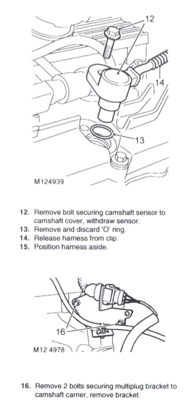

ben ns gaan snuisteren in de technical notes van Elise S2 : die sensor is effectief de camshaft sensor !
Eender welke sensor, als er 3 draadjes aanhangen is t zeker niet normaal als er 2 los (afgeknipt) zijn !
zie figuurke :
zie figuurke :

wat uitleg ivm camshaft sensor :
The cam sensor is a magnetic sensor that tells the computer on start up what position the cam is at in relation to the crankshaft. The computer uses this information to determine when to deliver fuel to the proper cylinders The fuel system on most modern fuel injection systems are synchronous so the deliver fuel only on the intake stroke of the proper cylinder. If the cam sensor becomes inoperative on most fuel system the computer will deliver fuel in a defaulted mode and the engine will still run but not as efficiently as it should. As to if the car will make a three hour trip. Probably but" life is a crap shoot there are no guarantees ."
Its a camshaft position sensor and some added features of you engine may be disabled. The camshaft is a rod with nibs on it to activate the valves. Without the cam sensor, variable valve timing will not work properly. Since most cars use this, it may damage your engine, such as valves not opening on time or staying open too long.....unless there is static valve timing backup provided by the engine computer.
It should still work...but may die unexpectedly....and may have trouble starting...
Mogelijke gevolgen van n kapotte sensor
If the car has no backup, the engine will blow or melt the valves and requiring replacement of the affected valves. There should be a very LOUD knocking noise if a valve is melted off....The valve will still move, but it will not cover the cylinder during combustion thus making a loud noise during combustion.....and you will obviously be dumping fuel because there would be no compression on that valve.
Mijn advies : ga zo snel mogelijk bij n dealer langs om dat te laten fixen (die hebben ook n OBD-device om de foutcodes uit te lezen) ! Wat je zelf kunt proberen te doen is die draadjes te herstellen, en ziet wat t resultaat is.

Ze lijken ook niet afgeknipt, eerder los geknabbeld, vind het maar vreemdBzguy schreef:ben ns gaan snuisteren in de technical notes van Elise S2 : die sensor is effectief de camshaft sensor !
zie figuurke :
