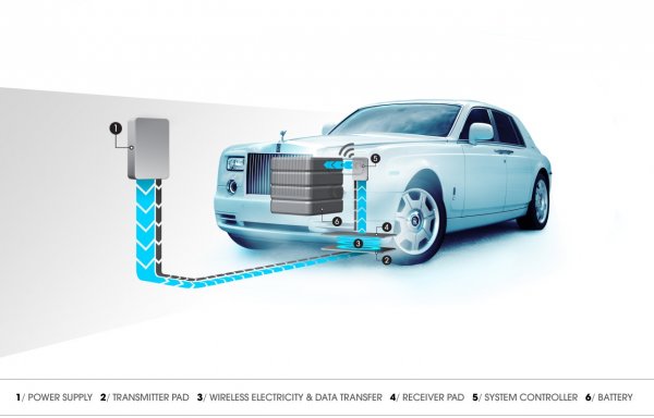

Lotus Engineering, a company with over 20 years of EV and HEV experience, has been responsible for all aspects of the electric drivetrain integration for 102EX, the Rolls-Royce Phantom Experimental Electric. This includes the largest battery pack fitted to a road car, together with an innovative 7 kW induction charging system. These components and the electric drivetrain have been integrated by Lotus Engineering into the existing Phantom electrical systems, giving an efficient electrical propulsion control strategy and retaining full vehicle functionality.

The Rolls-Royce Phantom is a complex vehicle with many advanced electrical systems. The integration of the electric drivetrain and ancillaries with the existing vehicle control unit provided the greatest challenge for the project. To compound this the Phantom Experimental Electric features the additional complexity of a 3 mode charging system (single phase, three phase and the inductive power transfer) together with a two level driver selectable regenerative braking system.
