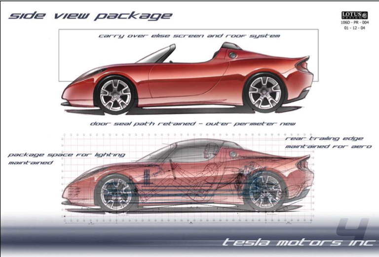

Engineering and Styling
Lotus Engineering principally does engineering and design work for other car companies. I dare say that few major car companies have not hired Lotus Engineering for some work or other over the years. Tesla hired Lotus Engineering for various bits of analysis, engineering, supply chain help, and of course, body styling. This time, I will focus on styling. In the beginning, I thought that we would carry over some of the Elise body panels – just because the cost of tooling so many parts seemed daunting when Tesla had practically no money. But Elon Musk (who, as a McLaren F1 owner, has pretty high expectations for a car’s looks) pushed me not to be such a wimp. Supercars are not made of fiberglass, and our market will demand a more sophisticated look than that of the Elise. Once I was convinced that carbon fiber was the way to go, everything Elise went out the window except (if you will forgive me) the front and side windows. Though expensive and time consuming, this decision gave us the opportunity to fix a few things: unlike the Elise, the Tesla Roadster includes federally-compliant 2.5 mph bumpers, federally compliant HID headlights, and all LED rear lights. A car’s windshield is an expensive and tricky bit, entangled with safety, rollover protection (when you consider the windshield surround), legal visibility requirements, waterproofing, interaction with the wiper, etc. It made a whole lot of sense to use the Elise “glass house” and rubber seal system. However, even there, we improved: the Tesla Roadster’s glass has an expensive but effective UV- and IR-reflecting layer embedded in it to keep the cabin cooler on hot days. With the basic vehicle dimensions, the glass house, and the drivetrain requirements settled, we hired several well-known sportscar stylists to submit proposals for the Roadster styling. I knew exactly what I wanted the car to look like – at least in my own mind. But I am one of those engineers who can’t even draw a circle. My six-year old boy draws better cars than I do. :-( I spent time with a couple of these stylists, describing what I wanted. The proposals came back all wrong. They looked like cartoon electric cars – all kinds of doodads, fake solar panels, bogus cooling thingies, etc. Not even close to what I wanted! I have a good friend, Bill Moggridge, who is one of the founders of IDEO, - a major design studio that designs practically everything except cars. Bill is a designer’s designer with cutting edge taste and impeccable style. He also knows me well enough to listen patiently to my ramblings and sort out what I want. Bill wrote a Keynote presentation for me in which he invented a 5-axis space that describes the looks of a car. For each axis (e.g. macho at one end, curvaceous at the other or throwback at one end and futuristic at the other), Bill provided example cars that typified the extremes. Then we negotiated where, exactly, on each axis I imagined the Roadster. We gave this presentation as a brief to all the stylists working on Tesla proposals. What a difference! Suddenly we were getting proposals that looked like what I had in my head. When the proposals came in, I emptied a room at my house down to blank white walls, and hung the dozens of sketches from each designer on the walls. We invited everyone we could rope into the task to vote on the proposals. I was in favor of a lengthy questionnaire, asking the viewers what they liked and did not like about each design. Bill had a better idea: give each viewer 3 red sticky-notes and 3 green sticky-notes. Red = bad, green = good. Put ‘em wherever you want. It was amazing. After the first 50 or so people voted with their sticky notes we saw the following: several stylists had a smattering of red and green notes on various features – a bunch of red notes on an ugly grille, a few green notes on an interesting taillight, etc. One stylist was so disliked that his name was covered with red (Okay, his last success was an SUV, so what should I expect?) But Barney Hatt – one of Russell Carr’s guys in the Lotus Design Studio – collected a wall of green. No doubt about it. Barney had a few red notes to be sure, but he was hands-down the winner. I never expected it, because his first proposals (before Bill’s brief) were awful.

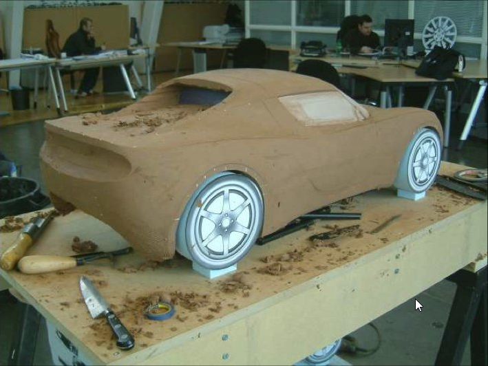

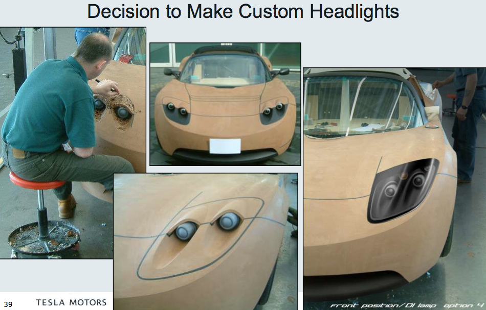

Elon and the Tesla team spent a lot of time – and several trips to England – working with Barney to perfect the styling. We changed a lot from his original proposal, and we worked with him to get what we wanted from the several clay models. I won’t bore you with the details, but here’s a few anecdotes: Barney originally designed the Roadster with a ridge down the hood that ended in a peaked front. This made Elon and me cringe, but I couldn’t sway Barney. What was it about the “beak” that looked so bad to us but not to Barney? Then it hit me. I was driving down the street and passed one of those iconic Pontiac Firebirds from the ‘70’s. Remember the ones with the chicken barfing on the hood? That Firebird had the exact same beaked look. To an American eye, the beak screamed “redneck.” But the British had the taste never to import that car… I sent him a few choice photos of the Firebird, and he got it.Also, Barney’s original sketches included a black front that was an attempt to integrate off-the-shelf headlights. This looked terrible on the ¼ scale clay model – someone dubbed it “the Lone Ranger” look. No matter how we tweaked it, the front looked bad. Again, Elon pushed us to spend the considerable money necessary to develop custom (and DOT-compliant) headlights to make the front look great.Just about three years from the day Marc and I started Tesla, we saw our first real Roadster from the assembly line. What a car! Bye-bye golf carts: this is what an electric car should look like.
